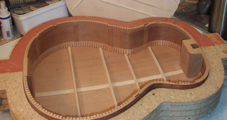

You asked about brace shape. I've seen some braces made from soundboard offcuts, about 3/4" wide by 1/8" thick or so. However, on my classicals, I go for more of a traditional shape. Here's a pic of the inside of my last build:

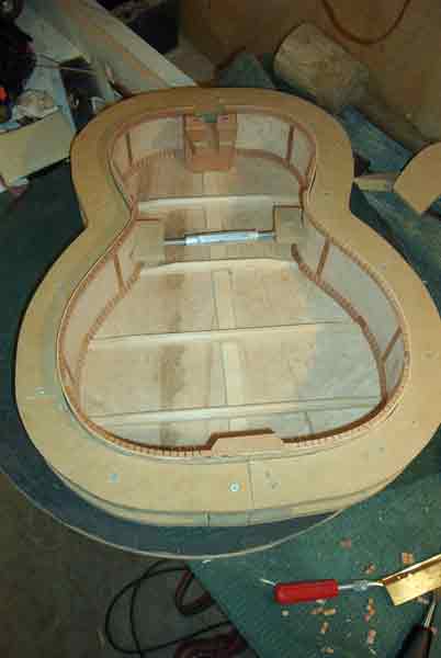

I have used both wood and cloth glued on with hide glue. HEre are pics of each
Wood
cloth
Both seem to work equally well.

Thanks for all the great info guys! And thanks for taking the effort to post some pictures. I just like to see the insides of some other people’s guitars.

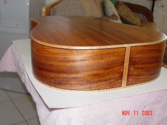

I use mahogany side braces because it looks OK with the mahogany linings. I extend the side braces almost all the way between the edges of the sides and glue two lining pieces (what are they called, the sections between the kerfs?) over them. It's the way Benedetto shows it in his book. The idea behind the braces not going all the way to the side's edges is that if the sides shrink the braces could push the plates out. That would also mean that the glue bond between the brace and side would have to slip first, so I'm not sure I should worry about it. Anyway, the main reason for doing it this way is to avoid a possible stress riser (?), a weak spot between the brace and the lining which can in itself lead to a crack in this area.
Sorry about the poor picture quality, here's a snapshot:

Arnt, your picture is just fine...nothing poor quality about it...and the guitar looks exceptional. Your work continues to impress!
Michael, that's some cool bracing on that classical! I've often thought about using bracin that was curved like that on acoustics.

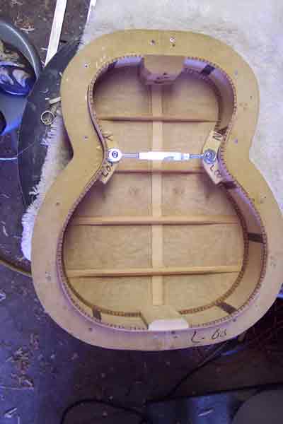

Here is a pic from Jim Olson's site. Notice anything missing?
So why would a guy who gets 8-12K per guitar (more in some cases) chose not to use the side braces?
Time to make a phone call.

Why? Because everyone has a different rationale for doing what they do. I use 'em, because it's cheap insurance, and I'm sold on the arguments, but the vast majority of guitars out there don't have side braces.
